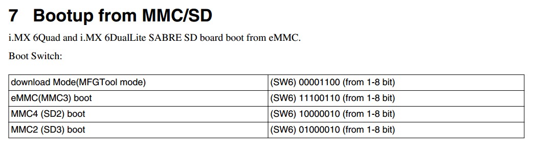

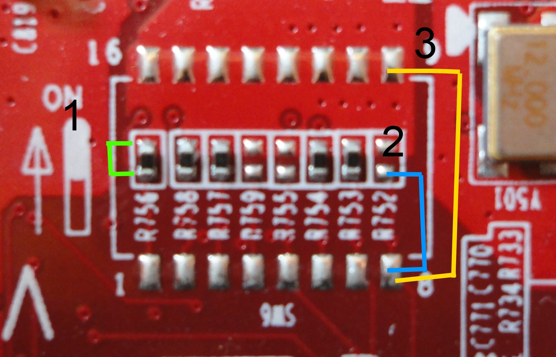

Our default boot device is EMMC,is you want to boot from SD card,you can manual change the boot device.
Next version we will add a switch button to change boot device.
Here is some information:
Boot device choose
Boot Device choose
As you can see the default is 1100110
BootPin
If you want to boot from SD3 you can use 0R Resistor to connect the pins.

Postby mijanek » Wed Apr 30, 2014 1:02 am
Hi Steven,
somehow I don't understand the wiring you proposed to use. I tought I would have to desolder R756, R757 and R754 in order to boot from sd3....?
mijanek
Posts: 70
Joined: Wed Jan 08, 2014 1:32 pm
Re: Updating system?
Postby steven » Wed Apr 30, 2014 9:56 am
mijanek Wrote:Hi Steven,
Hi mijanek
Yea, You are right ,you just need to disconnect R756 and R757 and R754, it is 01000010 then matrix will boot from SD3 . :)

Postby PeterB » Fri May 23, 2014 3:37 pm
I can confirm that I now have MatrixTV booting from the SD card (SD3), flashed from Ubuntu desktop, making it much easier for me to update, and swap between, releases.
