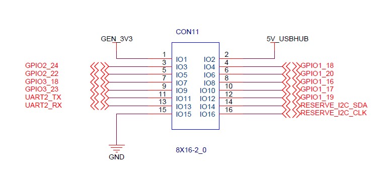

Hi All
With wolfgar's help :
http://stephan-rafin.net/blog/2014/01/0 ... r-receiver
We have already success tested IR receive with Matrix using the GPIO 3-18
Matrix-GPIO pic
This update will be added to
sourceforge.net/projects/matrixtv/
later :)
