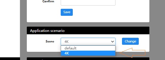

Hi all,
TBS2605/TBS2650 (4 pieces TBS2605) supports 5-channel fulL HD (1080P_60hz) or 2-channel 4K_30hz.
If you're using 4K encode, please be sure switch the "Application scenario" to scene "4K". This option is to provide optimal resources for 4K encoding.
Also, the video will be more smooth.
Last, after set "Application scenario" to scene "4K", need to reboot Encoder to activate. Setting option is on web page "Options---System".
