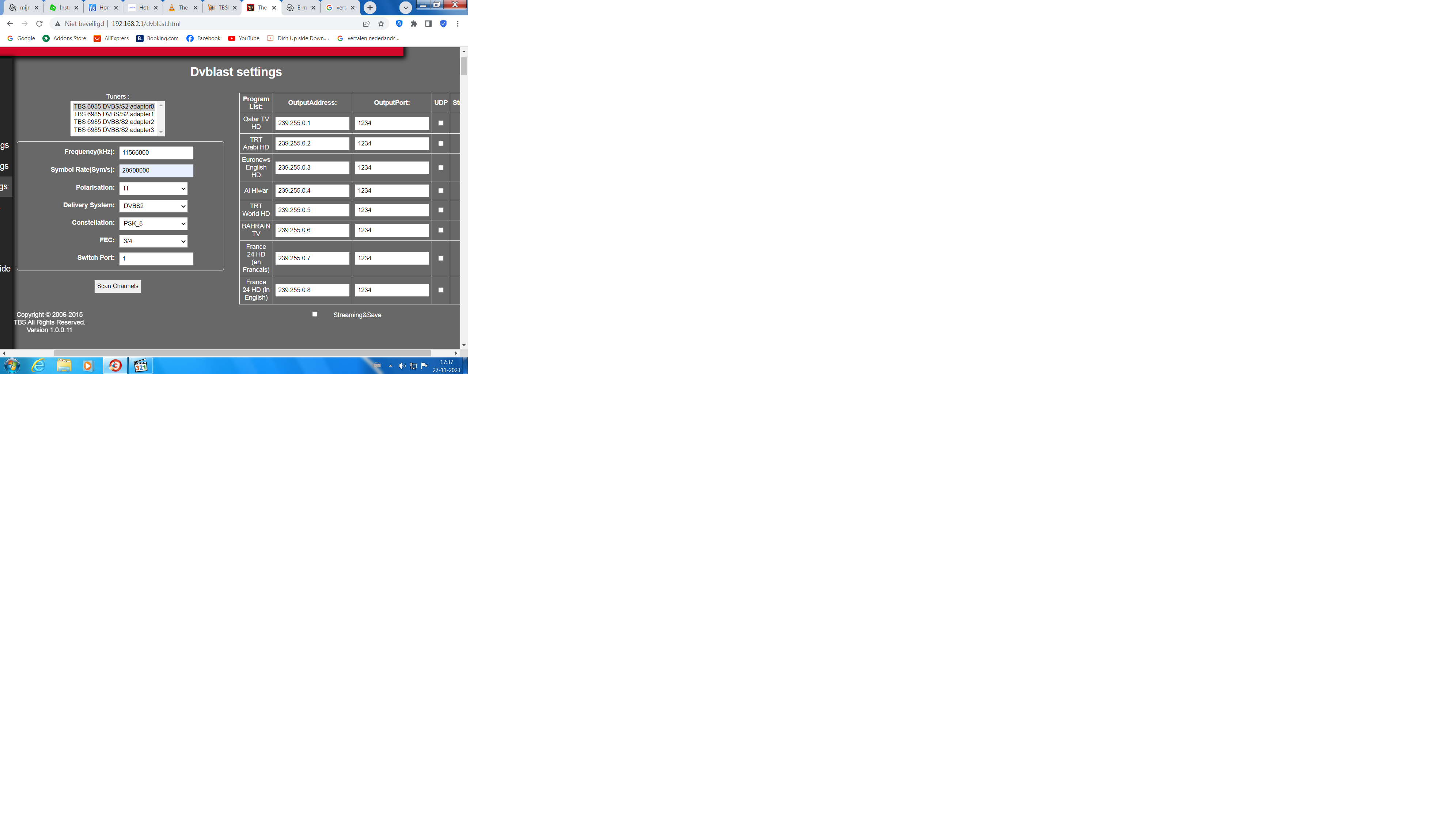

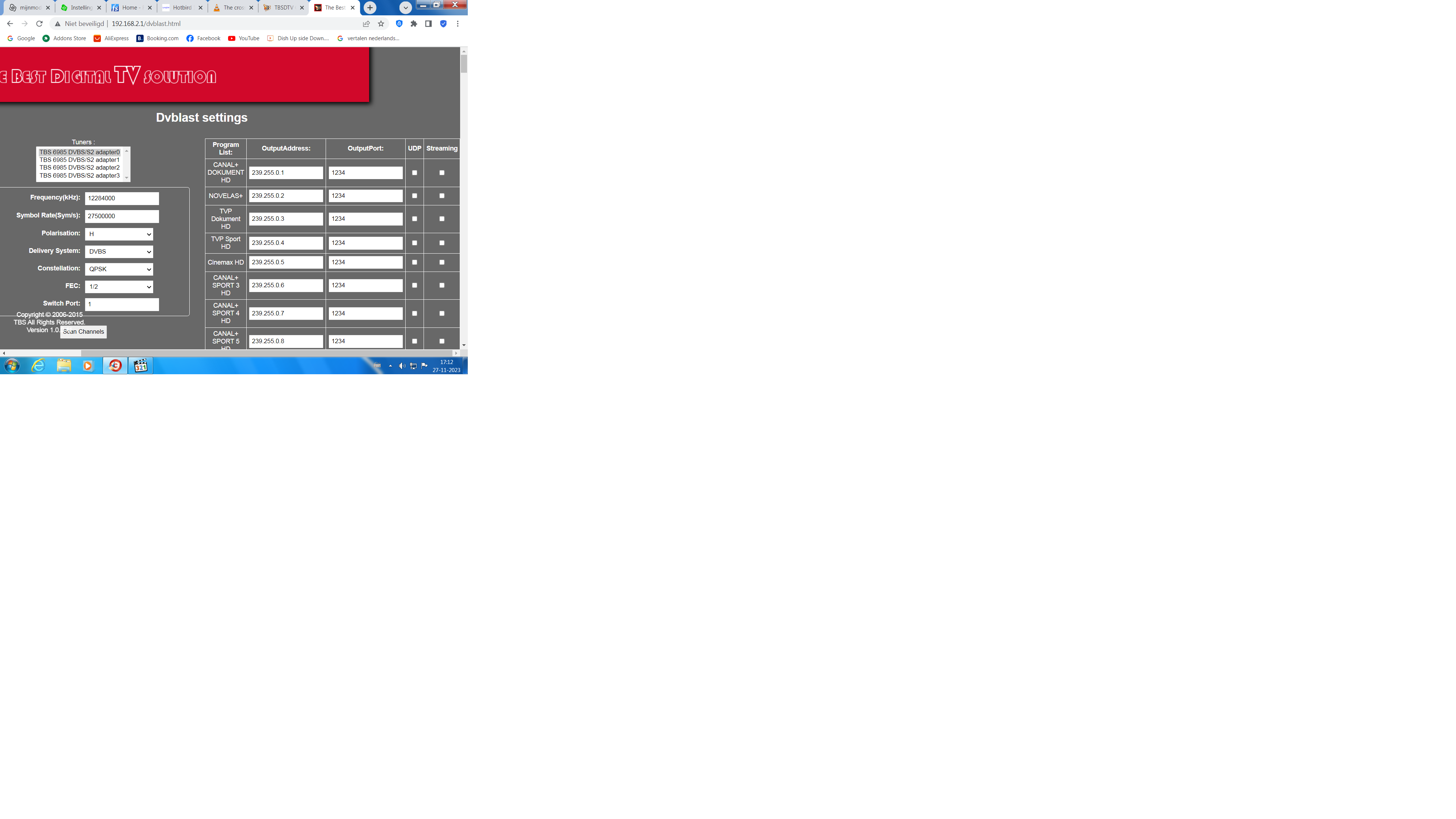

This is a very bad result.
You have entered 12284000.
Channels scanned are NOT from 12284000, but from 11449000.
Check it here, scroll to 11,449: https://flysat.com/en/package/platforma ... t-bird-13g
See?
And now the question is why you're getting some wrong results.
11449 - 9750 = 1699 MHz.
1699 + 10600 = 12299, so close to 12284.
Possible issue with band switching. Despite inputting frequency from high band you're still on low band.
