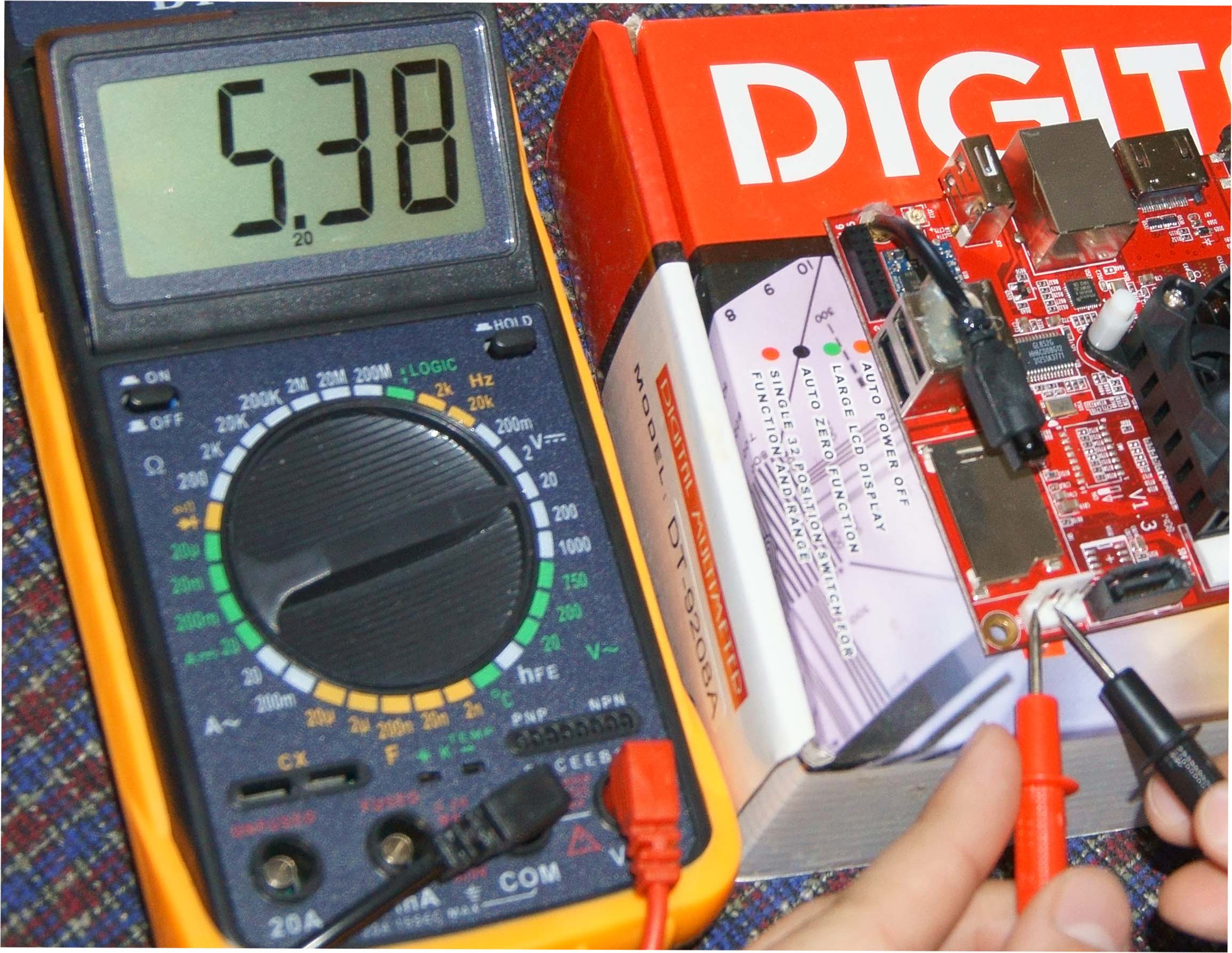

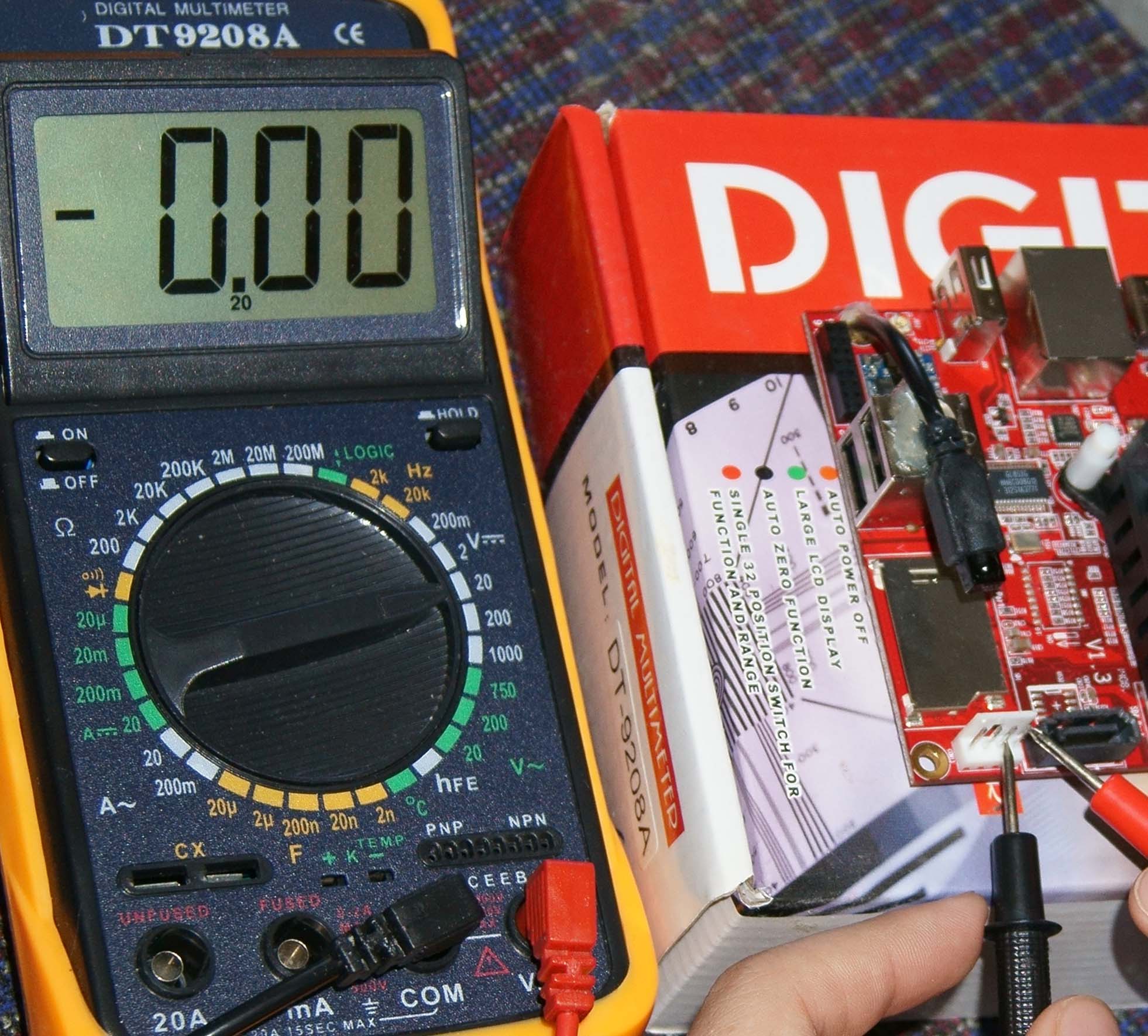

I'm checked voltage of TBS2910 sata molex connections and was dissapointed.
Contacts of 5 volt is OK.
But instead of 12 volt we have 0.
So device can't work with any sata hdd and manufacturer is deceived us!

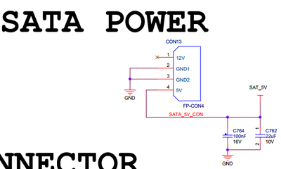

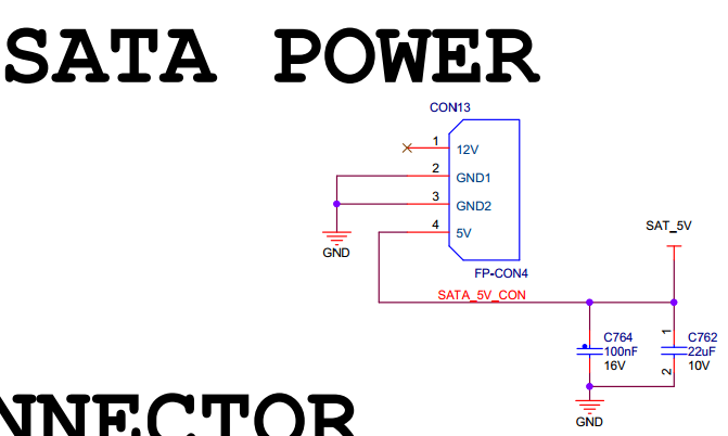

Accordingly "Schematic Diagram" CON13->12V go to NULL
from here http://www.tbsdtv.com/download/document/tbs2910/TBS2910-Matrix-ARM-mini-PC-SCH_rev1.0.pdf
So it is not problem of connection, it is problem of schema! So sata power will work only on photo of TBS2910 but not in real life. It is big lie of manufacturer. I will never buy any device from this seller.
