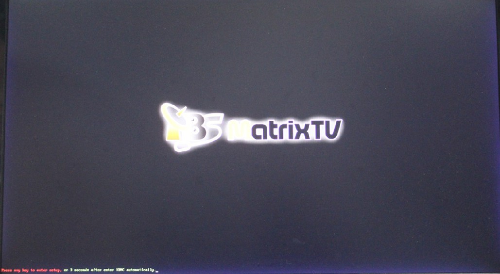

First Power on Matrix You will get the splash picture like this:
power on
Press any key to enter the setup dialog otherwise it will enter XBMC after 3 seconds

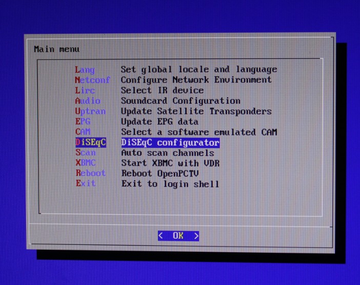

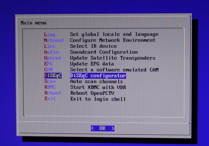

The main setting dialog:
Main Setting Dialog

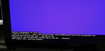

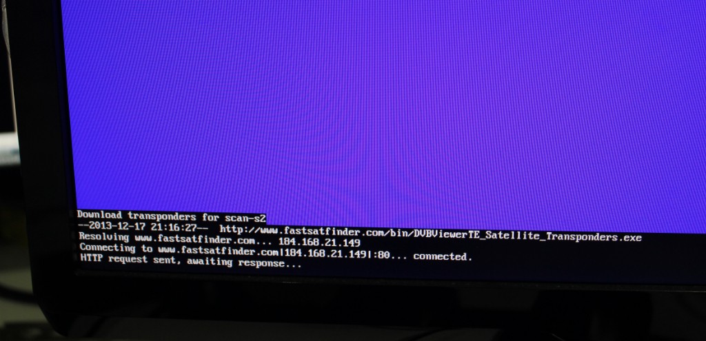

Click Update Satellite Transponders,If your network is ok ,it will auto update satellite list to the latest:

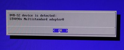

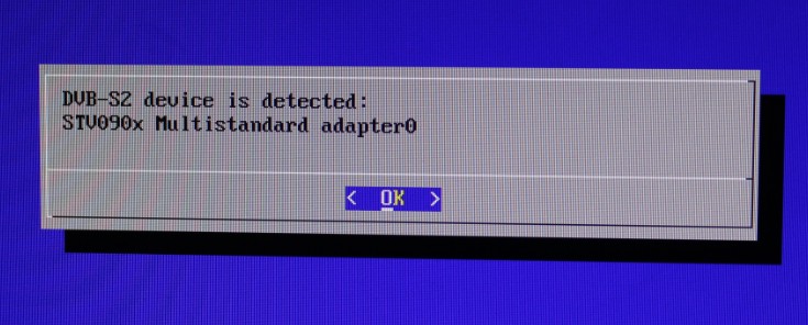

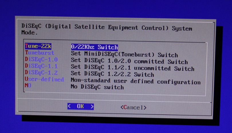

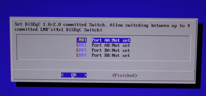

Then Setup your Diseqc,below picture shows success detect TBS5980
Enter Diseqc Dialog
Shows success detected TBS5980

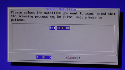

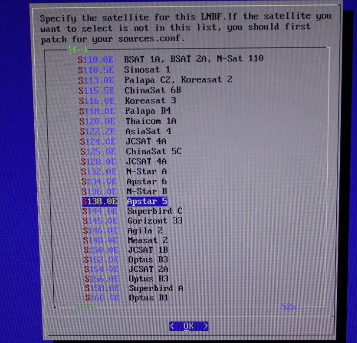

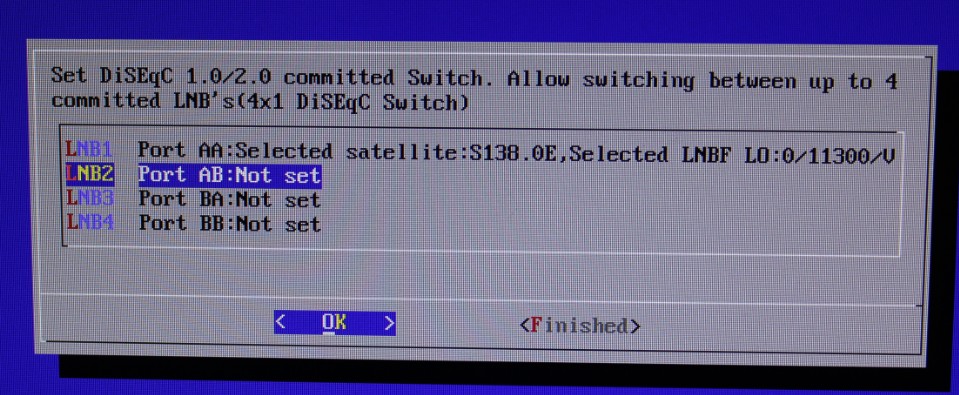

Select the Diseqc you are using:
After config the Diseqc, return to the main dialog

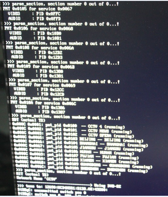

click Auto scan channels then it will auto scan the channels for VDR like this:
After scan all channels. Then you can start watch TV with XBMC.

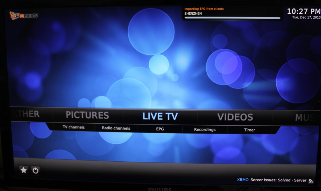

Return to the main dialog click start XBMC with VDR.

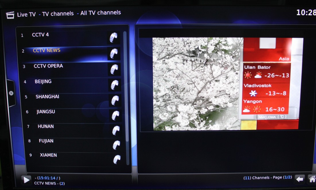

Then you will see the XBMC's main dialog.
Click Live TV then you can see the channels you scaned like this:
Ok you can enjoy with MatrixTV now. :)
