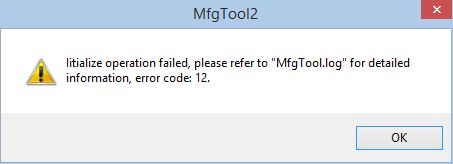

Postby Kestouf » Thu Aug 14, 2014 5:33 pm
When I execute MfgTool2.exe I have error message (piece attached)
In MfgTool.log:
DLL version: 2.2.3
Thursday, August 14, 2014 11:32:09 Start new logging
ModuleID[2] LevelID[1]: Error: Can't find the specified list(SabreSD-eMMC-use-batch-file) in the xml file
ModuleID[2] LevelID[1]: Parse ucl script failed, error code: 12
Kestouf
