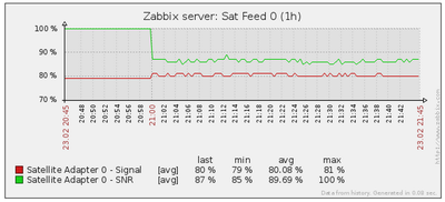

I had to say, for a while, I thought it was sorted. I had watched a couple of programs without any issues, but then 10 minutes before the end of a program the artefacts were back. It was HD. Dancing on Ice and at 8.45/8.50pm, 15 minutes before the end, it was very corrupted.
It was recorded on adapter0 and the attached graph shows no problem with signal and SNR (as reported by femon). It drops off at 9pm when (presumably) the tuner no longer locked onto the frequency.
Next thing to try is constantine's patches. Interestingly, there were 3 programs recording at the time, which lends me to think it's a PCI-E bus speed issue and/or driver-related.
Will report back if the recompiled driver (with Constantine's patches) helps in due course.
